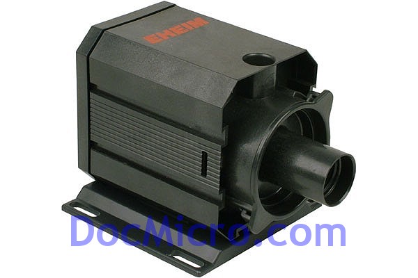

- Pompe Eheim 1250
http://www.docmicro.com/images/pieces/Eheim_1046.jpg
